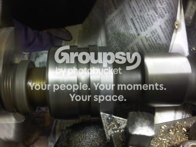

Non les paliers de l'aàc, MFaulks a été obligé d'usiner un aàc d'A610 pour le monter dans sa culasse de test qui lui sert à relever les levées de soupapes:
I was about to test and digitise the A610 cam profile but the cam wouldn’t fit my 3ltr bench test head. The cam journal closest to the sprocket is larger in diameter… interesting, so you couldn’t retro fit A610 cams in an otherwise OE 3ltr 12V head... I guess to try and keep the parts exclusive to that build, and hence my question about the Bi-turbo units as well? :?
Hence, a little rough turning and the lobes were soon digitised for my records :wink:
As it turns out the cam isn’t that special, and has some similarities to the old turbo Buick profiles :arrow:

C'est curieux comme différence ?! :grattelatete: bizarre...
En tout cas pour le coté arrière j'ai une culasse d'Alpine A610 et l'arbre de BT se monte sans soucis :angel10: .
